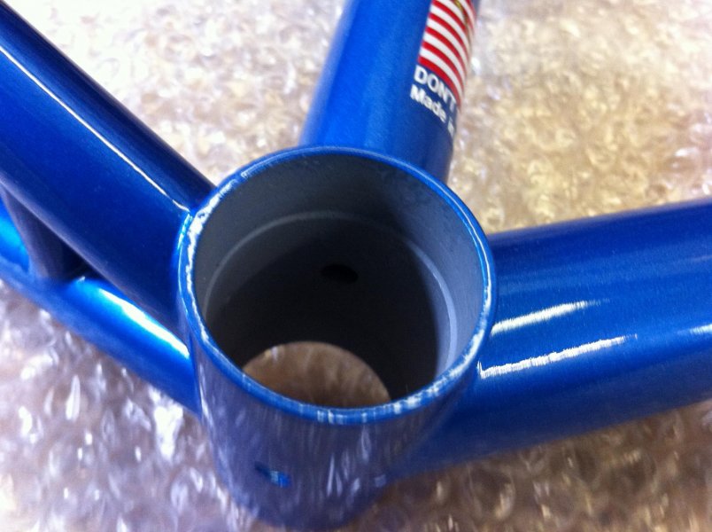

Yes the square tapered bottom bracket. When I was looking through the parts for the bike I saw the bottom bracket and the bearings but I didn't see any nuts to screw the parts in securely.
What you have there is the spindle (which is square taper) and the locking collars. What you need is the bearings (described in the link above). You don't need to do any screwing or nutting, just smooth solid pressing (once you get bearings. After you do that, insert the spindle, center it, and tighten down the locking collars. Be careful--if those are the originals they are liable to break easily (if they aren't broken already). They are also Imperial not metric sizing.

Thank you for all of the bottom bracket information guys! I have the original NTN bearings but one is seized so I need to replace it. I will follow the direction in the link and hopefully that will work well.
