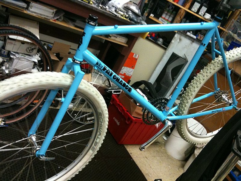

Just for some basic build info:
Frame: 1989 Wicked
Fork: 2011 Igleheart with Wright dropouts
Headset: Chris King Gripnut
Stem: Salsa (90mm)
Bar: Easton Matrix
Seatpost: Origin 8
Saddle: Selle Italia Leader
Shifters: Suntour XC Expert, 8spd
Brake Levers: DiaComp SS-5
Cantilevers: Shimano SLR DX, flat black
Crankset: 1989 Shimano XT, Shimano chainrings
Rear derailleur: Shimano XT RD-M735 Shortcage
Front: XT
Chain SRAM 8spd
Wheels: Campagnolo Athena 8spd, Campy QR, Mavic 231, DT butted spokes, blue alloy nipples.
Tires: Yet to be decided. Running Smoke/Dart.

Zamfir
White tires, Pulstar hubs.....
Chainstays are just wide enough to rock the Schwalbs.
