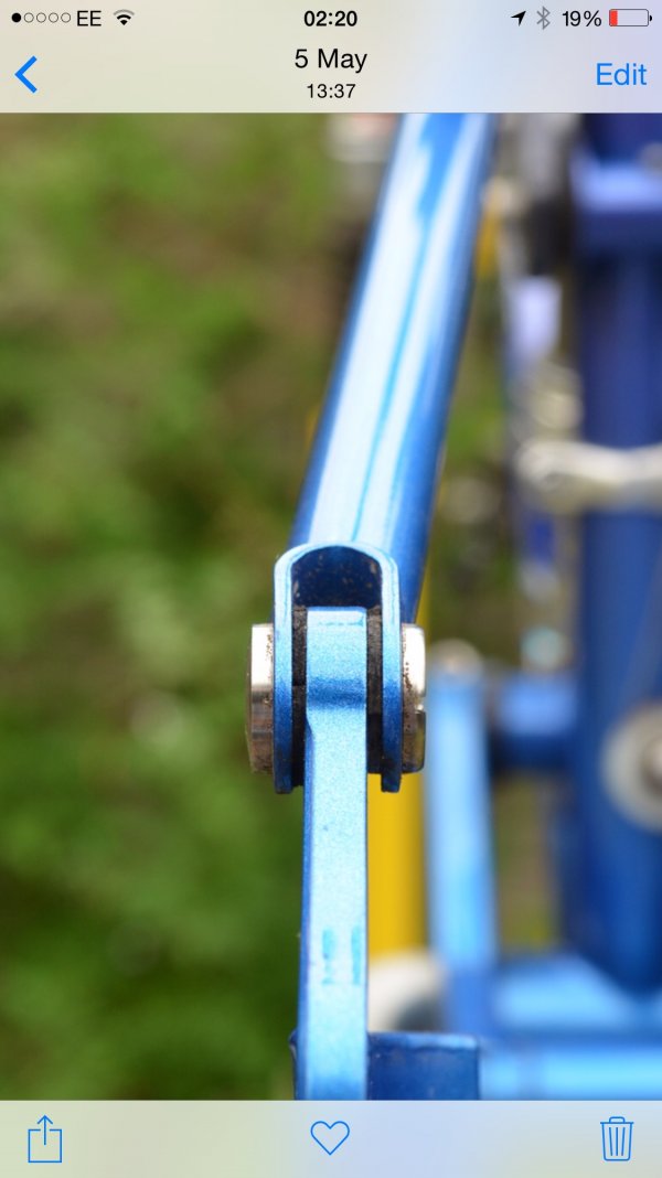

Does anybody know a current supply source for suspension spares, bearings, bushings etc for the SAB MKII ? Are the parts fairly standard dimensions ?

I was talking to an old racer today in my LBS. Fingers crossed he can find a specialist who either stocks something or can make them for sensible money ;) I will keep this thread updated for future reference. It would be a shame if they can be enjoyed properly when the parts wear out.
