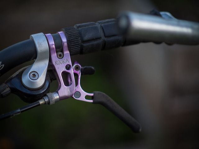

Kooka brakes, need some work. They also seem to be seized to the bars. I'll see what I can do to salvage them:

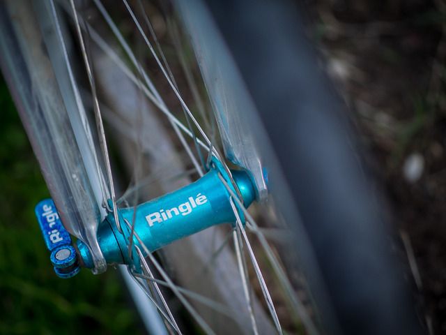

Ringle front hub. The rear wheel is mismatched. I'm guessing the original rear Ringle hub failed:

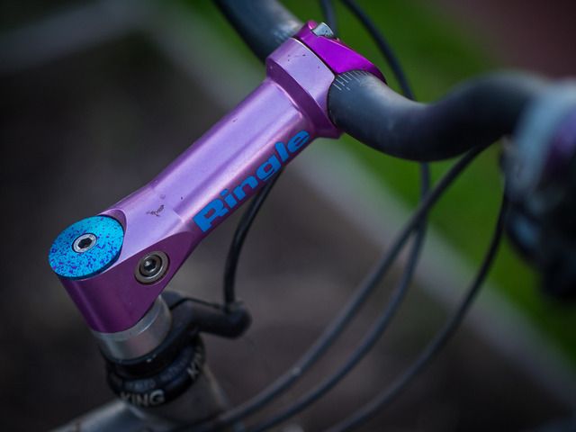

Cool Ringle stem, but it's ridiculously long. Not sure what I'm going to replace it with, but I would like a 50mm or 70mm stem:

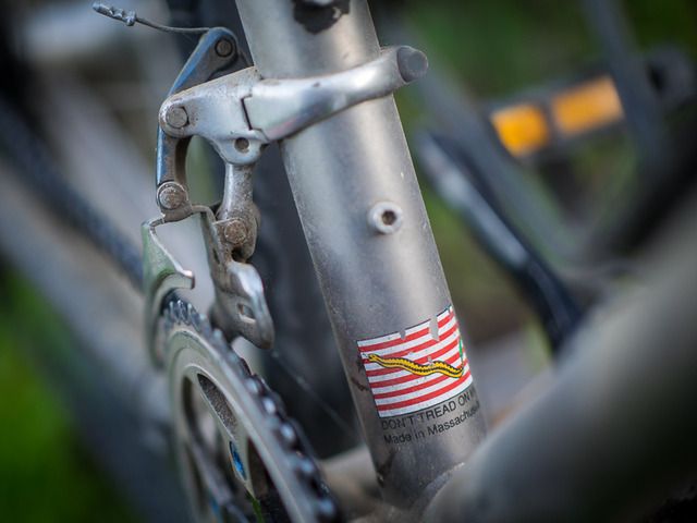

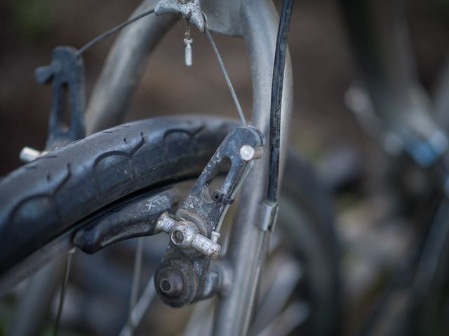

Does anybody know what brand brakes these are?:

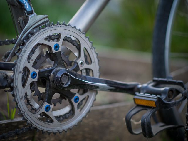

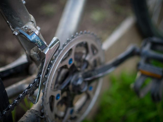

Are these Grafton cranks?:

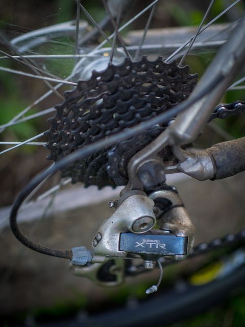

I'm stoked on the XTR shifters and derailleurs:

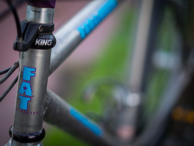

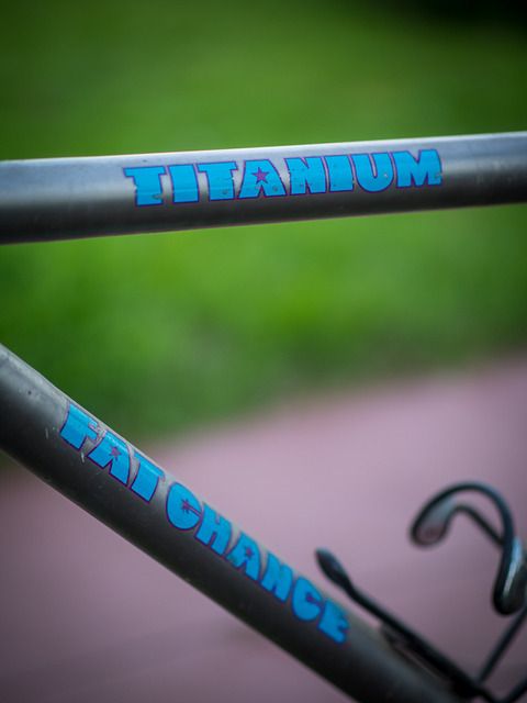

Wow...you have literally found he holy grail FAT, a 94 mint and no frame dents or chainsuck...hopefully.....and in the most desirable size M/L. Sure you have had offers coming in by the bucket load. I have the same 94 in L - see pic and i will never sell it, incredible ride, firm yet so comfortable all day.

The brakes look suspiciously like Grafton Maglite's. Very nice.

The Kooka brake levers seem to be very seized to the handlebars. I can't get them to budge. Their overly complicated internal clamping has backfired after 30 years. I tried using some persuasion (channel locks and a rag), but could barely get the brake lever to rotate on the bar. I fear any more persuasion will damage these delicate brakes.
Also, the XTR shifters might be done. The rear shifter won't hold the gear and the derailleur falls back down to the smaller cogs, after shifting up. It's almost like the internal gears are stripped. The front shifter seems really sticky, internally. One of the levers doesn't return to it's position after shifting.

I run my stock XTR derailleurs (I am the original owner) with shimano bar cons and the Pauls converters - so they operate like thumb shifters (except nicer).

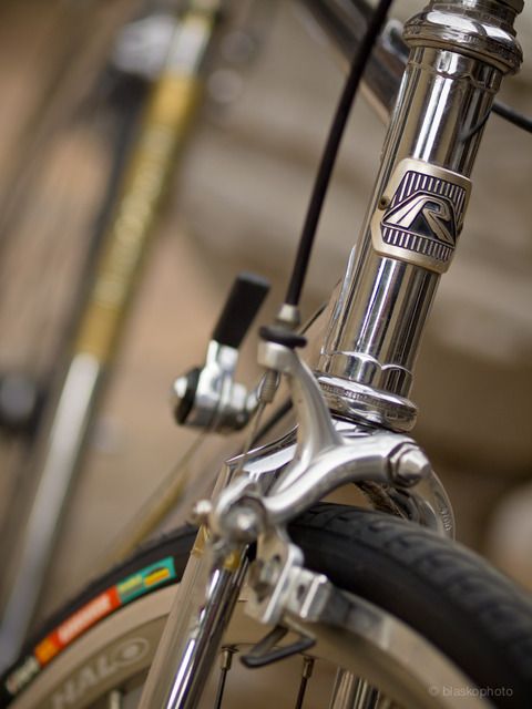

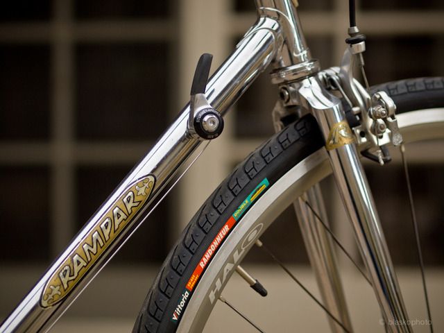

I suppose the first step should be to find my thumb shifters, mount them up and see if they still shift well. I've got a set of Ritchey True Logic cantilever brake levers, but they're currently installed on my vintage road bike, a 1978 Raleigh Rampar Tange Prestige!
sriracha

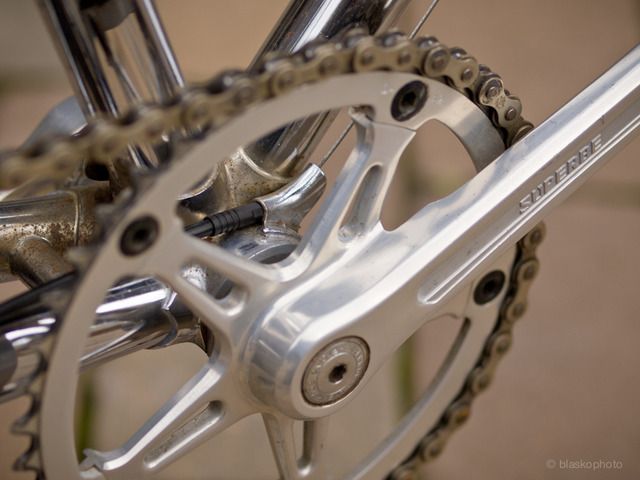

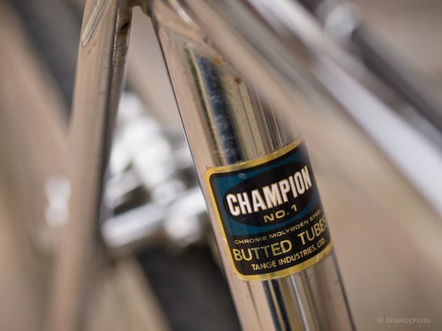

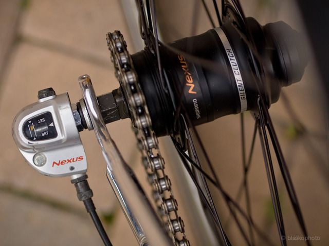

Since we're all bike nerds, I hope you don't mind me sharing pics of my vintage road bike, that uses the Ritchey True Logic canti levers. I built the wheels with a Shimano internal gear 3-speed hub. It's a smooth ride, 1978 Rampar, Tange Champion #1 tubing!:
Sweet street ride :cool:
